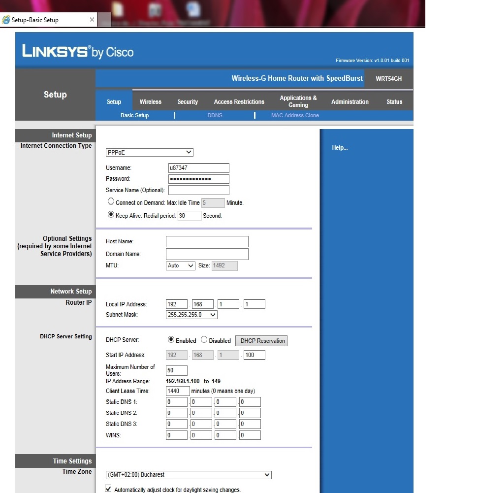

Post by aleksey85 »
astea sunt setarile din routerul principal
Asta e routerul principal

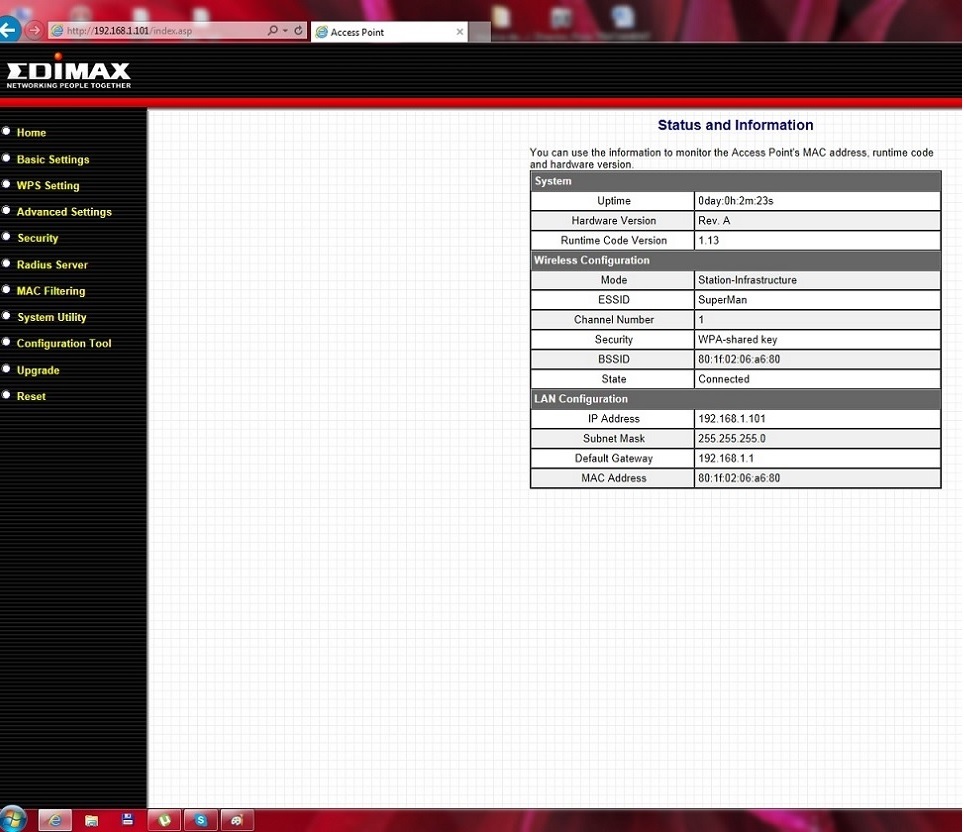

Post by aleksey85 »
Acces Point
aleksey85
Posts: 29
Joined: 25 May 2014, 15:27
Re: 32EH5450 - Problema conectare la internet prin Access Po
Post by aleksey85 »
AP pag2
